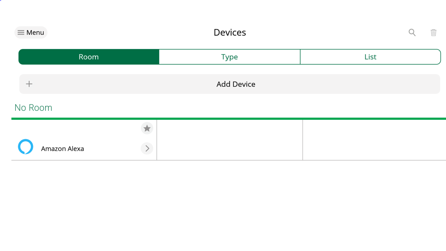

I just lost all setup and pairing to my EZLO PLUS!!! It went back to Defaults!!! No time zone NOTHNING!!!
This is crazy. The only thing remaining is alexa!

Face the same problem, everything is gone only google, alexa and a virtual device is left. switches and sensors gone. Not sure what caused this. I was playing around with the restore backup that didn’t work and the I selected the option Reboot Ezlo. After these actions I had a “new fresh” hub. Using the mobile app I first had to select a region and then found that Alexa, Google and a virtual device was in.
Ohh heck yes everything is gone!!! The only thing it had was Amazon Alexa - and after it asked to set time and date..It had my device name!!! Well i guess 90% on the items I attempted to pair none was working correctly (NOT fully integrated-but they “get credit for them”!!!) I open tickets on for over 3 weeks-everything is now gone??? YES I did power cycled the unit and it sat overnight!!! Still gone!!
Be careful. The reboot command name is very poorly chosen. It is a factory reset of the Ezlo. I had the same running the hub.reboot command via the API tool.
