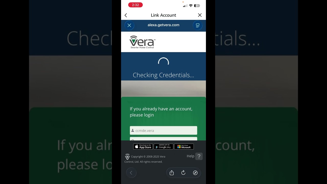

The Alexa skill won’t control my devices anymore as it’s disabled. When I try to enable it I get prompted that the certificate for the alexa.getvera.com page is expired. It seems me to allow to continue to the login page, but after trying to log in it’s stuck at Checking Credentials.

I’m having the same problem. When I try to verify my account it first takes me to an error message that my connection is not private. Then if I continue I get the endless verifying credentials message.

Dear users,
We recently experienced an issue with the Alexa integration for Vera controllers due to an SSL certificate problem. If you encountered difficulties linking your controller, please try updating during the login process when installing the Vera skill in the Alexa app, as shown in the attached video.
This action should resolve the issue for most cases. If you continue having trouble, please contact our support team for further assistance here: https://support.ezlo.com/hc/en-us#contact-blocks.
Thank you for your understanding and patience.
— Ezlo Support Team
