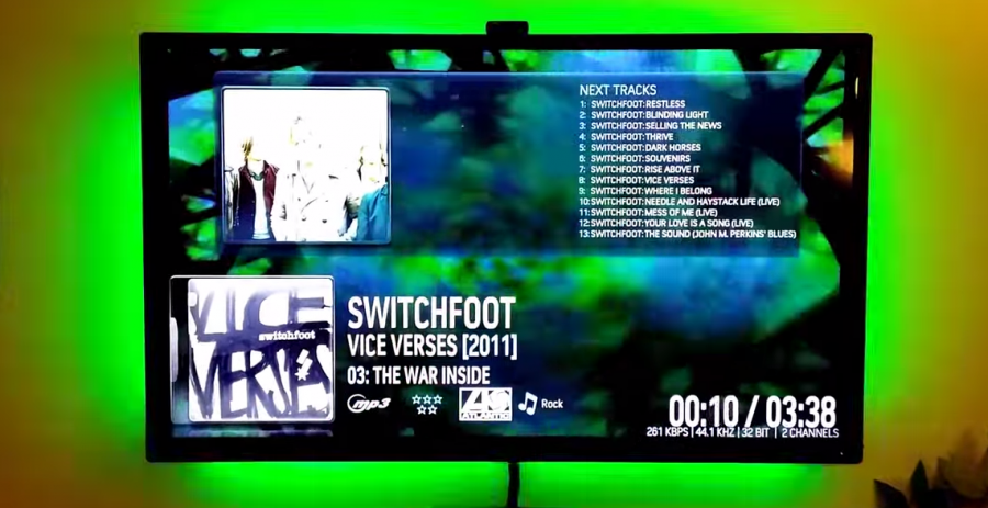

For anyone wanting to do this XBMC Z-Wave integration, I wrote a step-by-step guide with a video demo…
I hope this helps!
