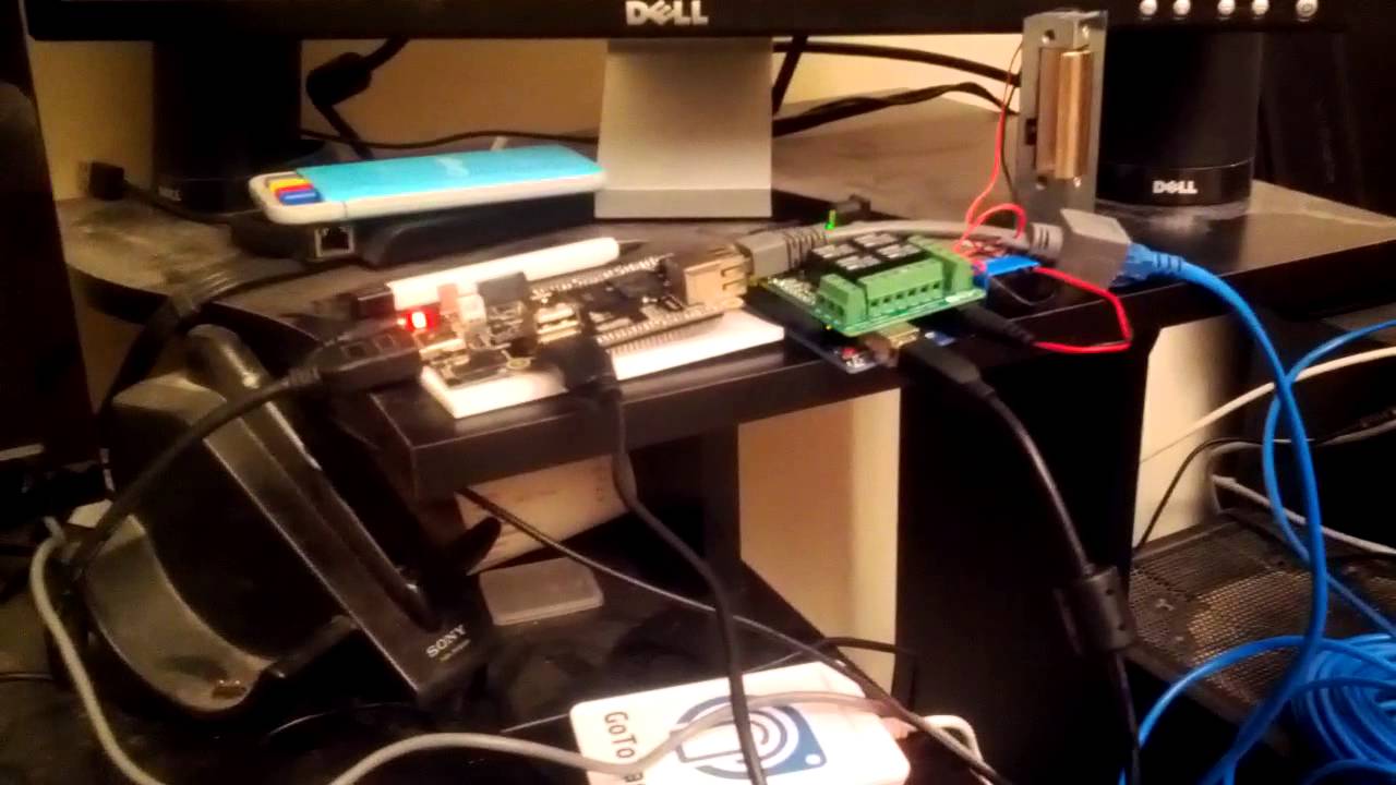

After you got that hooked up then all you need is a away to open it from the outside. For me right now I’m playing with Arduino interfaced to VERA. For about about 30.00 you can get an Arduino board (uno, Nano, Or micro) and a RFID reader with cards or use your NFC phone to open the door. You can also use a keypad mounded with the RFID reader for both options.
The Arduino plugs into Vera VIA usb or Ardunio can be plugged into the network and VERA just needs the IP address. There is a plugin for Arduino to work in VERA. And once that is installed and connection made you can have VERA use it like any other Z-wave device. Log, auto lock, unlock, unlock threw a VERA app or what ever.
