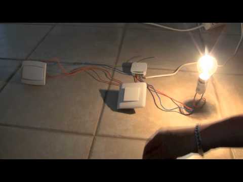

Yes. What you are describing is a 3-way configuration. But the precise details of how it will work depend on what Z-Wave switches you use.
If you use a Fibaro or Aeon micro switch, with standard electrical switches, then it will work as you describe.
If you use a Z-Wave replacement switch, the switch paddles will most likely be momentary.
