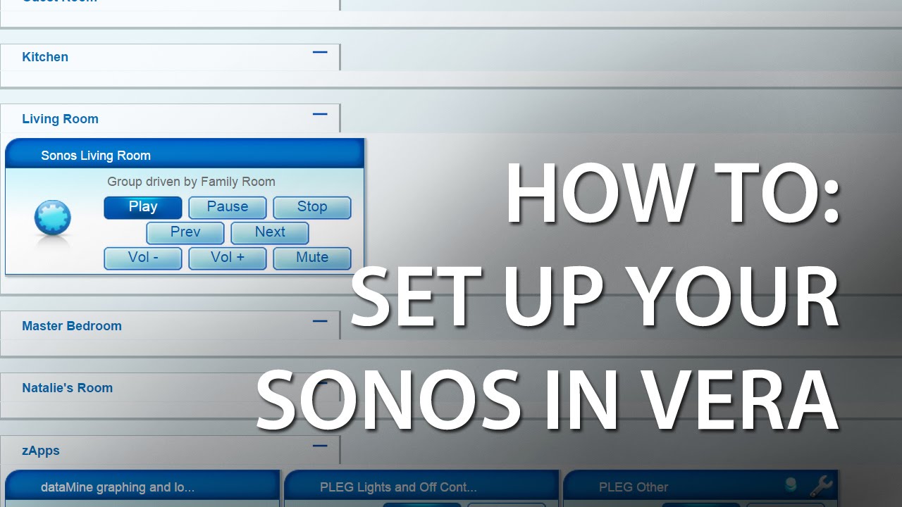

Some YouTube stuff, the first is Vera Traing the the other two are specific to Automating Sonos. I have not watched them but there were referenced in other threads and created by a member of the forum to assist in these cases…
