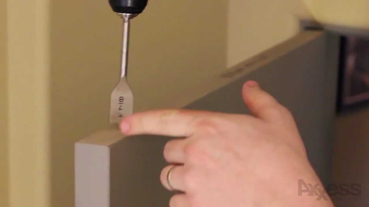

I used contacts like this.
http://www.smarthome.com/seco-larm-sm-207-5q-w-short-round-magnetic-contacts.html?src=Froogle&gclid=Cj0KEQiAuremBRCbtr-1qJnKi-4BEiQAh0x08J8jk326UBeXXXkihpyX9E0SG0mhwLdbJV0sJw_y1oIaAhub8P8HAQ
But even if you go wireless in alarm panel you can use wireless hidden sensors like this. Same install as above but wireless is used in the video
If you go z-wave you need bulky sensors on outsides of windows or doors.
