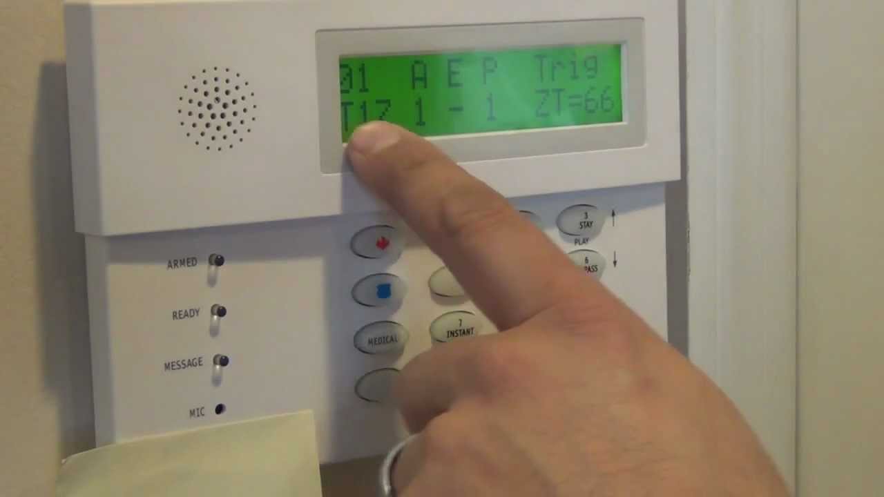

I was tidying up some cables (having been inspired by S-F) and came across an ELK 912 relay. It hit me that I could power cycle the router using the alarm’s output. So, for about $9.00 I can now reset my router using vera (pleg) once a week or whenever the Ping Sensor says I cannot reach outside the lan for some extended period.
I even set it up to power cycle by pressing the D button on the alarm panel. My wife can now restart the router, which is nice if I’m unavailable.
I used these instructions from youtube, which are terrific:
