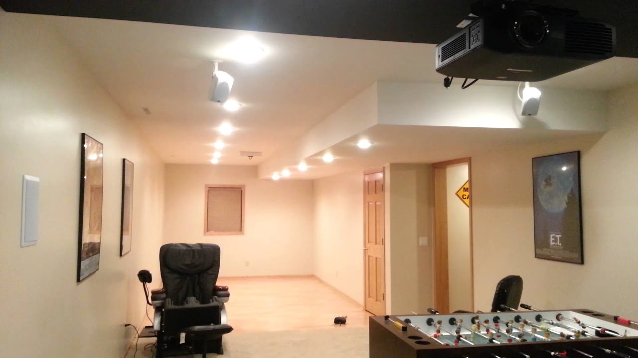

I’m using a Logitech webcam for the mic. I finally got around to uploading a video to youtube that shows a little of the hardware and the whole thing in action.
