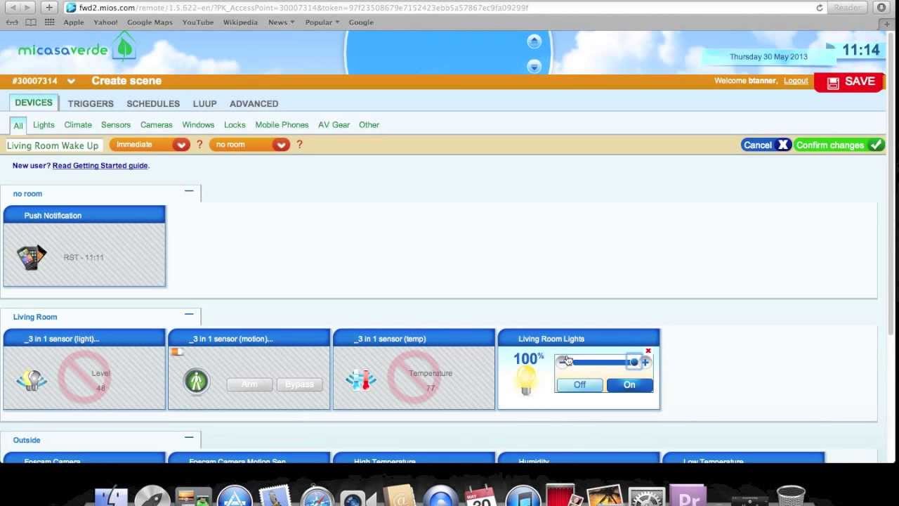

If you REALLY don’t want to use PLEG watch this video for an idea how to do some things using the arm functions.
PLEG is a lot more efficient, and easier to program once you get the hang of it however.
