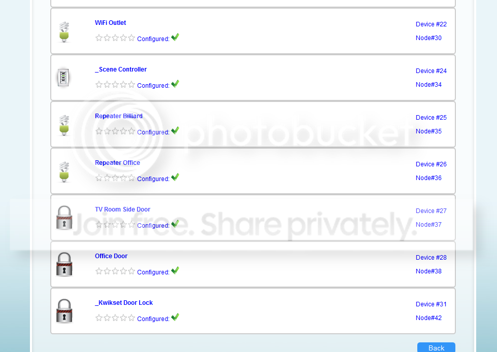

FDB, have you run a network heal? If so, what was the results of the report?
I have done many, many heals on this network with various configurations of the repeaters. I never knew what to make of the heal report, it says “Hover over a device to see which devices it can see” but that does not work. Perhaps someone here could tell me what it means? Here is a screenshot of some of the report
