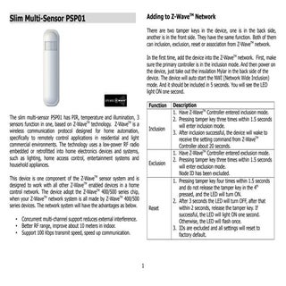

I have several of these:
I am having a hard time understanding if/when the temperature & illumination sensors are refreshing. From reading the manual in the above URL, I think I am gathering that it refrehes the temp & light sensors every 6 hours by default, and the fastest refresh you can get is every 30 minutes.
It says that to adjust from the default, you adjust settings # 12 & 13 (Auto Report Illumination Time & Auto Report Temperature Time), but I cannot find these parameters in UI07. When pairing these 3-in-1 sensors, it creates 4 devices:

That manual makes my head hurt. It’s awful! What you need to do is set configuration parameters on the device in Vera. To do that:
Click on the device → Device Options. If there is not already an empty Configuration settings variable field click Add Configuration settings to add one to the list. To do what you asked, you need to enter the following configuration variables in the appropriate field.
Variable Data Size Desired Value
6 1 Byte Dec 64 – Send report if temperature changes by 3 degrees. Bit 6 set to 1.
12 1 Byte Dec 1 – Send illumination report every 30 minutes. Not needed for temp.
13 1 Byte Dec 1 – Send temperature report every 30 minutes.
Then click Save Changes and then Save.
Other parameters are listed in the chart at the end of the manual. References to setting bits need to have the bit number set Least Significant Bit(LSB) first and converted to decimal for the parameter’s desired value setting.
