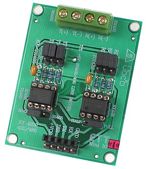

Not sure if this would help, it was beyond my skills, but I was trying to use a Raspberry Pi that I had bought and a USB/RS485 (about $60 total)
Since your iAqualink would now support the Http get commands that I linked earlier, you might be able to use a Raspberry Pi rather than the $300 Autelis.

I don’t because I was never able to get the thing working on my Raspberry Pi, but with the Autelis (or RPi) it’s the link between the RS485 aquabus and TCP.
Like I said it got over my head but maybe someone on here might have some ideas. With the Autelis PDA version I was only able to query a couple things and get a response. With the iAqualink chip there is a whole host of things you can do (but you would still need the RS485 serial bus connection as far as I know to pick the message off the aquabus) but the TCP/IP link would otherwise be through Zodiac -which uses the four wires aquabus to talk to interface host where your antenna plugs in to the power center (I am guessing it’s much the same way the Honeywell talks with their thermostats, in which this guy was able to reverse engineer ( Brad's Thermostat Control Button ) talking to the thermostat.
There might be something in this posting that might help you (Control your Jandy equipment from your PC with a $15 adapter | Trouble Free Pool) to get a piece of hardware to talk on the Aquabus, but otherwise I don’t know. I have also attached the serial command that Jandy uses.
