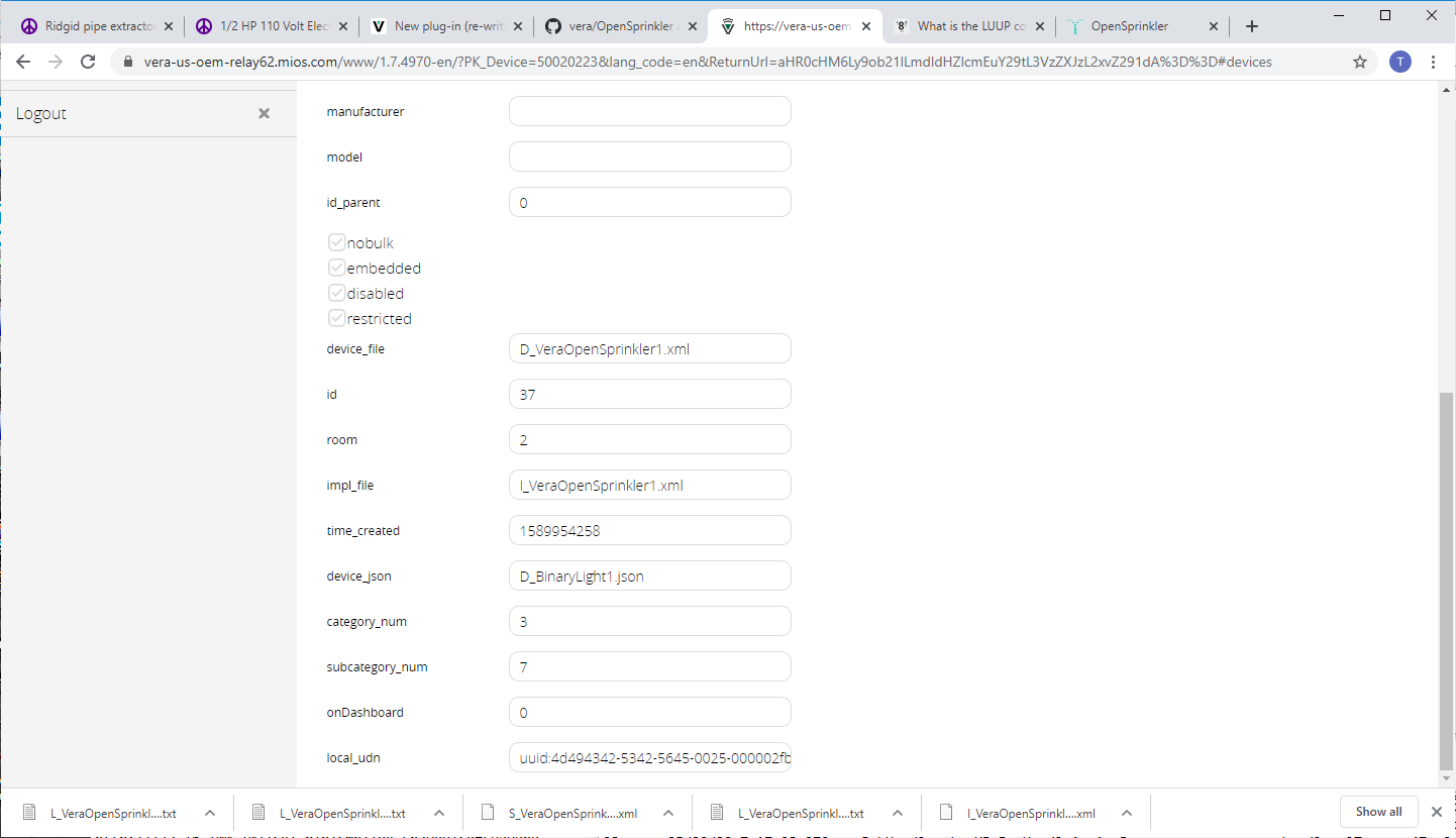

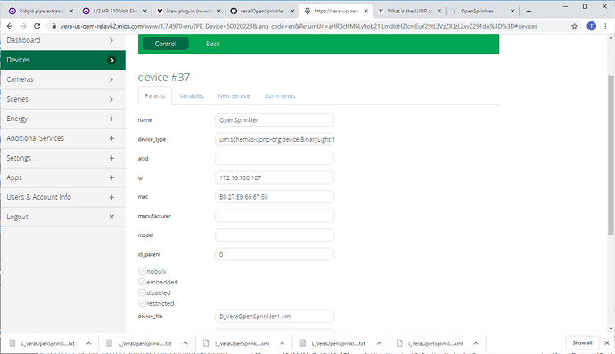

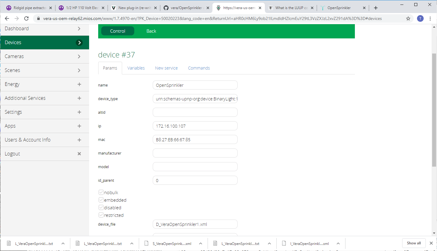

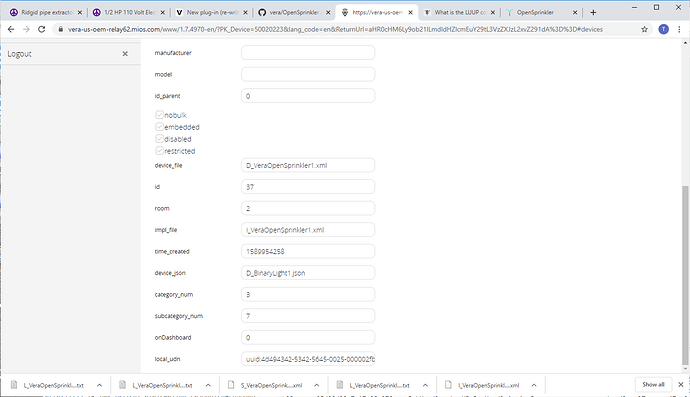

Also, you need to update the readme on github with
As device type, please insert
urn:schemas-upnp-org:device:BinaryLight:1
and as device_json
D_BinaryLight1.json
and it might be helpful to add that you can reload luup with the command
luup.call_action(“urn:micasaverde-com:serviceId:HomeAutomationGateway1”, “Reload”, {}, 0)
in the luup test window since the Vera does not provide a button to do it.
Device type is not mandatory. Luup reload con be called with luup.reload(). I will update the doc accordingly.

DebugMode is set to 1? Can you please post a screenshot of the mater device Params? (under Advanced, then Params in device’s details). Thanks.
Device seems to be configured ok, but logs are not showing. I need verbose logs in order to help you, I’m sorry.
