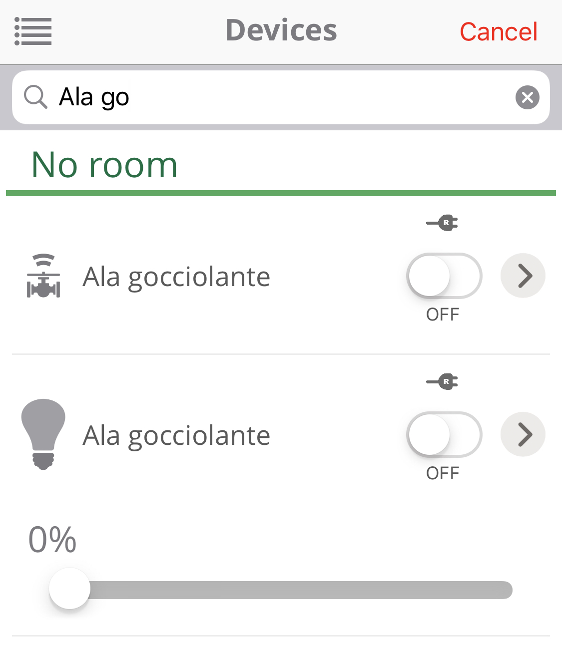

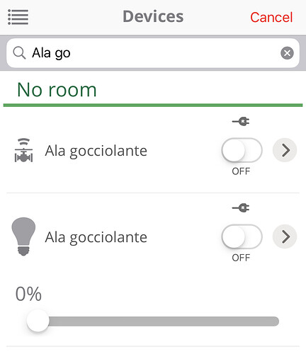

I see the “light bulbs” for the zones in the mobile app as well. (The programs DO show the valves, however!)
In the old plugin, I think the developer had a sprinkler head. When it was “on”, it had water coming out the top. This also worked for the mobile app. Maybe those can be used?
The good news is the app works great and the zones/programs are in “unknown category” so they won’t respond to “all on” “all off” commands. ![]()
Thanks again!

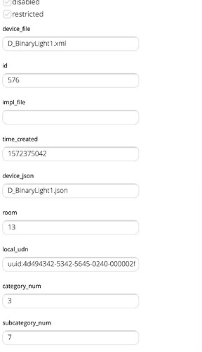

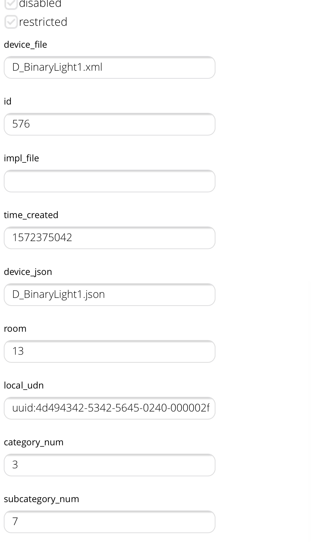

The other one is not supported by mobile apps. What you see is a bug I already reported in the web Ui, introduced with fw 7.29.
Edit: I also asked for a generic dimmer, but since this fw is practically dead, I don’t think it will ever be added.
