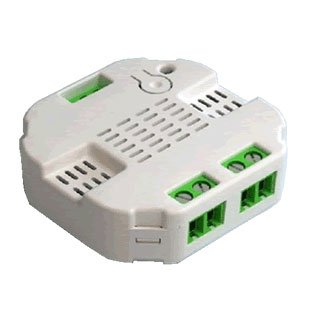

I have since bought one of the Aeon devices (DSC26103-ZWUS, $30 on ebay closeout) that converts a regular on/off switch to ZWave. The module fits inside the box and is controlled by the old switch. These are a good way to convert on/off only situation to ZWave control without changing style and look of switch location. You need some spare room in box so if it is a small box and chock full of wires it may not fit. I would use Aeon and a plain Decora switch instead of the rudely priced $75 on/off Vizia switch I used. Live and learn.
Aeon also makes a dimmer module in similar vein to the on/off switch but I haven’t used it so can’t say anything about it.
