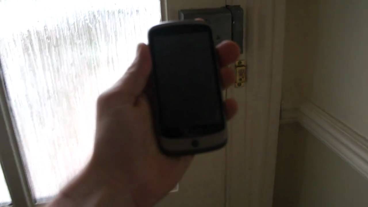

Glad you chaps are using it ok.
I’ve made a small demo video of it in action - not how to set it up but just it alerting me whenever my front door opens :
and here’s a direct link to the android app in the marketplace : https://market.android.com/details?id=com.fawepark.veralert
I’ll be doing some updates to the app over the next few weeks - ie different alert levels etc. but if you have any ideas, let me know.
Richard.
