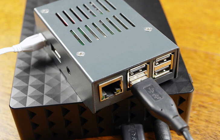

Having decided to re-purpose an old Raspberry Pi, I thought I’d have a go at creating a new trusted link between my Vera and the Pi, leveraging the wise words and content from above from @rigpapa
I’ve placed this guide here all together mainly to remind me in the future :slight_smile: but also to help others as there were a number of different approaches used above influenced by how people were original set up…
