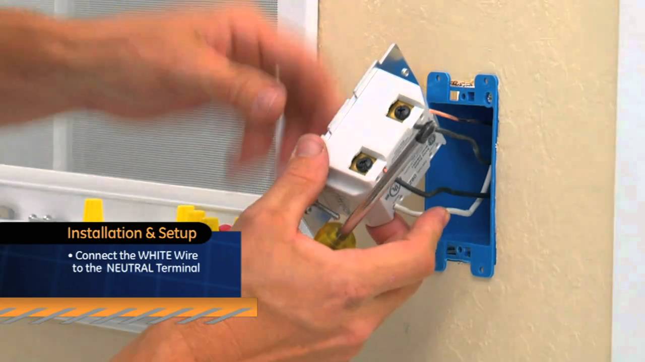

The GE/Jasco 45609 is a simple On/Off switch. It will operate ANY 120VAC light, regardless of incandescent, CFL, LED, etc.
Here’s a youtube video showing the install:
