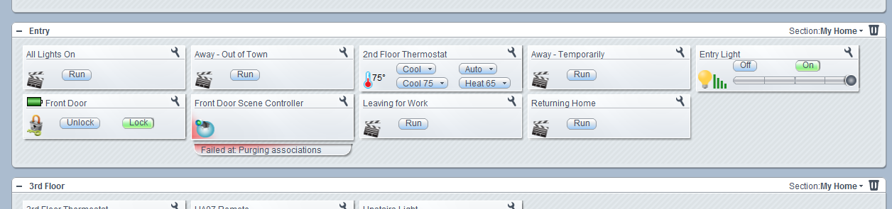

Failed at Purging Associations w/Monster 4-Button Scene Controller
I’m almost finished replacing all of my switches with Z-Wave hardware. I moved some Z-Wave switches (let’s call them 1 & 2) from one place to another because I wanted to replace them with dimmers. 1 & 2 are now installed in a different location & all switches are working well. However, I have a Monster/Leviton 4-button scene controller that was working before I moved 1 & 2, and now it is not. Adding the new dimmers and moving 1 & 2 to another location are the only changes I made. After moving 1 & 2, I updated neighbor nodes and everything was fine, but I was getting this in the Vera interface:
I followed the Leviton instructions to de-associate the switch, factory reset it, and then re-associate it; not a fun task, but it seemed to work as far as the step-by-step instructions go. However, I still have the above status for this controller in Vera.
Please help! Everything else is working really well.

Well, as far as it being a “distance” issue, I still have control over another switch in the same box as the scene controller. My condo is configured a bit like Intrepid’s house, from the sounds of it. The scene controller in question is installed at the front door (in a 3-gang box and within a foot the Kwikset), and Vera is on the “2nd” floor.

OK, chalk this up to a learning experience–maybe. If you can picture it, Vera sits in my entertainment center on the middle floor of my place; behind the entertainment center is a wall, and behind that wall are stairs going down & left to my front door. On the side of the wall opposite Vera, I plugged in my last remaining plug-in module, added it, and updated neighbors for everyone. Now the scene controller is working just fine (after checking the boxes to enable events on each of the four scenes). Maybe it just needed time; maybe it just needed an intermediate node. I dunno. It’s working now, though… and I need some more plug-in modules.
