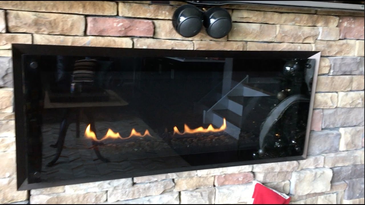

Hey everyone,
I have an electric fireplace that has a remote with 4 settings:
  1. Lights on
  2. Heat setting 1 (remote send same signal as lights on x2)
  3. Heat setting 2 (remote send same signal as lights on x3)
    4.Off
    I have successfully decoded the 433MHz binary signal and can send the lights on and lights off signal via an ESP8266 connected to a transmitter. I uploaded some code for it to function as a webserver so that when I get my Amazon Echo Plus (I live in Canada) next month it can recognize the device and send the signals.
My concern is that it will only send the lights on signal and I’m unsure how to code the Heat 1 & 2 settings eventhough its the same signal just sent multiple times. Is there anyway I could have Vera recognize my ESP8266 to trigger the 4 functions through a switch in the device UI from my phone? Im also open to other suggestions for operation.
Thanks in advance for your help!
