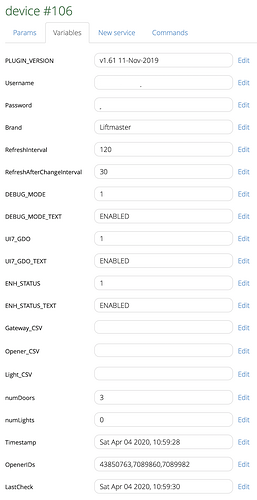

@tomtcom, thanks. Please set DEBUG_MODE_TEXT to ENABLED and make sure DEBUG is set to 1, retry and post the logs. If you want to reduce scrubbing, you can PM them to me.
@blacey sent now, thanks.
Thanks Tom. So even with the Liftmaster APPID, we are still seeing the 217 response code.
(MyQGateway::MYQ_API::inspectDevices): response [{“ReturnCode”:“217”,“ErrorMessage”:“Error processing request (217)”,“CorrelationId”:“e16c8e3a-d7aa-49a0-8ebc-ca446a6f3207”}]
