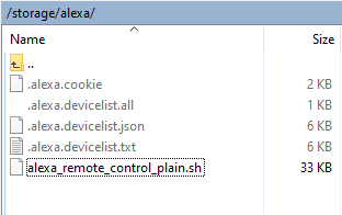

I am not using two step authentication on my Amazon account, however the TTS stops working after a while this is the second time its stopped working for me today.
Looking in the Storage\Alexa folder I only have two files:
.alexa.login
alexa_remote_control_plain.sh.
Last time it stopped working I manually did the cookie thing in Firefox browser again and added my cookie file.
Why is it not automatically renewing the cookie file ?
Thanks
I still had the .alexa.cookie file on my laptop’s desktop that I generated last time a few weeks ago.
I just uploaded it in to the Storage/Alexa folder using WinSCP and now the TTS is working again.
I did not edit or update that .alexa.cookie file in anyway.
I now have these files showing up.
So should my question of been why does the .alexa.cookie file and the other files seem to vanish from the Vera unit ?
After copying up the .alexa.cookie file again these are the files that reappeared.
.alexa.devicelist.all
.alexa.devicelist.json
.alexa.devicelist.txt
And the .alexa.login file I could see initially has now gone.
Looking at the .alexa.cookie file that I had just hanging about on my desktop, it was modified on 21st January, so presumably that was the date I used the Firefox browser and plugin to generate it.
So the TTS has worked for nearly a month.
I’ve had this happen once only. And I have a copy of the cookie file in the alexa folder in case it happens again.
Probably should have looked in the login file to see what it said. May have been a one time captcha type thing if you’ve been behaving oddly.
