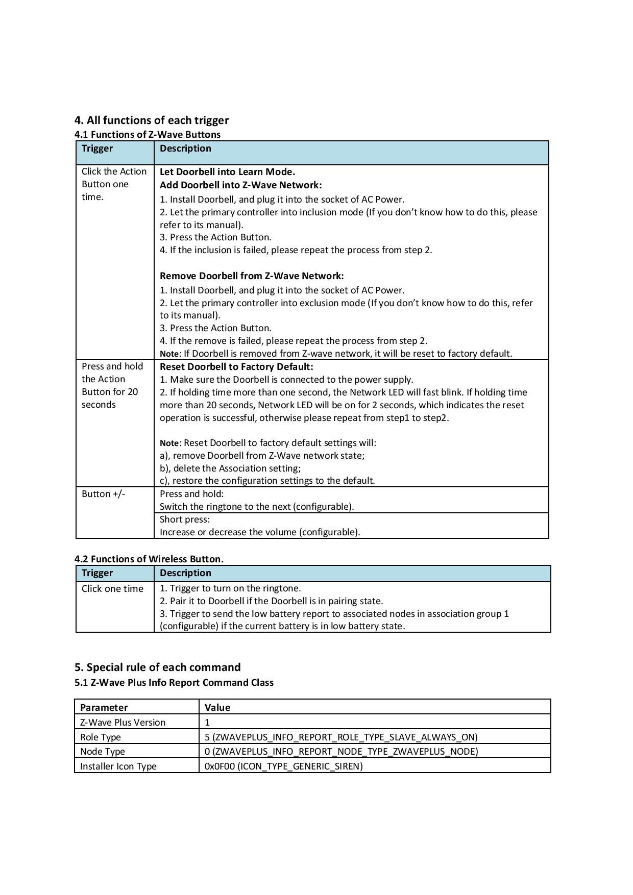

Some additional information I found on Aeon Doorbell Type Beta - Community Created Device Types - SmartThings Community and http://www.pepper1.net/zwavedb/device/827
Parameter 2, Size 1, Set the repetitions for playing doorbell ringtone.
This was helpful since it defaults to repeating the sound twice. Setting this to 1 successfully stopped that.
Parameter 5, Size 1, Set the default doorbell ringtone
Parameter 8, Size 1, Set the volume of ringtone
I did find that playing a tone will set off the trigger for the doorbell so it’s helpful to disable notifications before playing a tone and re-enabling them after.
