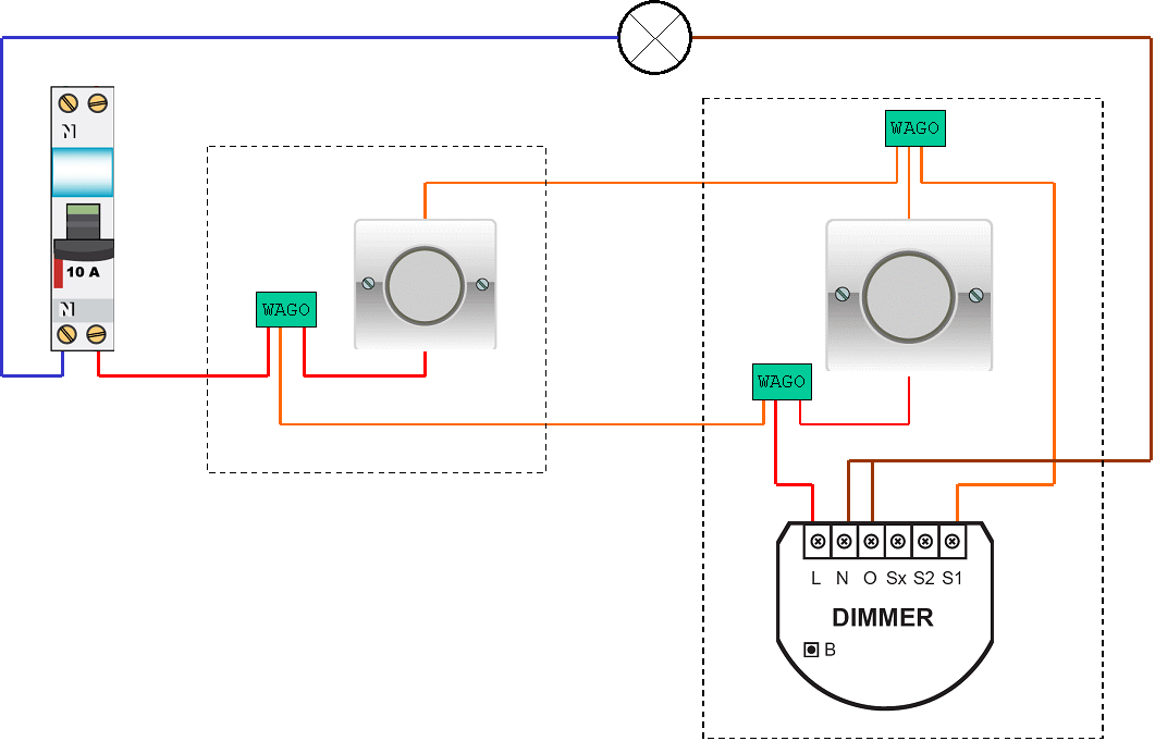

Hi,
my installation is like this :
I would like to install the Fibaro Dimmer (FGD 211)
Can you help me ? Is it the good way ?
If you want to modify the drawing, just do it : http://bit.ly/AzJQVa

I’m no leccy expert, but i think you should have switch 1 going into S1 and Sx, and switch 2 going into S2 and Sx. Not sure if that’s physically possible though, I’m facing the same question at some point this year to…
I agree with you this works ;D
But I’ve to connect S1 and S2 not to Sx but directly to L ???
You have to add to the dimmer configuration one parameter :
10 with the value 1.
When it’s physically possible this solution works fine

This is just to confirm that it really works!!
I’ve tried another forms, but in the end this was the solution:
the dimmer is on the last switch wall box, since FGD211 controlls the O (output), so it must be in the last position.
My solution was a 2 wire (no N) and the switches were a “3-way” type.
Any question, feel free to ask.
